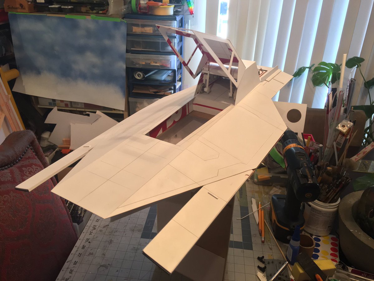

Cardboard U-wing in 1/18 scale progress
Update on my attempt to build a U-wing toy out of cardboard in the proper scale of the 3.75" figures:
* I took the plans for the 30mm U-wing papercraft model, and scaled the major parts of the ship's body up 250%, printed them onto paper, and cut them out to use as templates for cutting pieces out of cardboard.
* The type of cardboard used: pizza boxes, and shipping boxes which are thicker.
* Everything is held together temporarily with tape.
* Eventually I hope to remove all the tape, glue everything together, fill in and shape joined sections and exposed cardboard edges with modeling putty. Then prime and apply brush paint.
* I'm going for a Hasbro Star Wars vehicle toy aesthetic, both outside and inside. This isn't meant to look realistic, like a model. So I've been studying photos (on Rebelscum) of various large Star Wars starships that Hasbro have released in recent years. In particular, the many Clone Wars ships have been most interesting and inspirational for me to study, especially the Republic Gunship.
* Keeping things simple and toy-ish, I plan to use the same limited color palette of the official Hasbro U-wing vehicle for 3.75" figs: white, gray, black, blue and yellow.
* The wings are in scale. To try to maintain rigidity and mitigate their weight, they consist of three layers of cardboard starting from the sides of the U-wing main body, then to two layers, and one layer at the tip. However, the wings still weigh heavily, tipping the vehicle toward its front, and putting strain on the main body of the ship. I may need to compromise and shorten the ends, just as Hasbro did with their versiom of the U-wing for 3.75" figs. The weight of the engines could counterbalance this. But again, weight from the wings and the engines could put too much strain on the main body.
* I do plan to make the wings swing back, and I modified the original papercraft model plans to accomodate some kind of mechanism for this, which could simply be a wide nut, bolt and washers. (The wings of the original paper model do not move at all.) The problem/challenge to figure out is going to be the weight of the wings.
* I plan to release more photos showing step-by-step details of the build process (e.g. the measurements), sometime after I've built the engines and figured out how to make the wings swing stably. I want to put this information online so others can make their own 1/18 scale U-wing. :)

1:18 scale U-Wing UPDATE
Here it is. What’s left to be done is gluing everything down, adding finishing details, and painting.
As promised, I put together the templates I made into a package of PDFs and photos. I wanted to release these to the public before Rogue One officially comes out on disc and online later this month. You can download this package as a single zip from here:
http://www.mediafire.com/file/n6j4s6jvabvrpl2/
As a bonus, this package includes a PDF to make an Imperial data drive (AKA the Death Star plans) for Jyn to carry.
To be honest, I’m so sick of looking at this ship -- because I spent a lot more time on this than I expected. LOL. I don’t know when I’ll get to gluing everything. So I look forward to seeing if others will try to build this 1:18 scale U-Wing. All put together, the ship is large: about 55 inches long (with the wings folded in), and its wingspan is 6 feet when the wings are swung back.
May the Force be with us!
